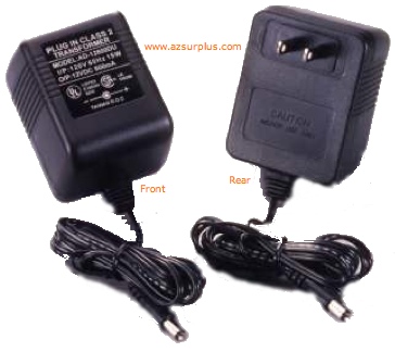

Im in America, was wondering how the voltages/plugs work out. Is it fine to use with 120 volt outlets or does it need a transformer or an adapter

So the transformer will be inside the power plug you use. Best for the LXR is around 7.5V with >=600mA
