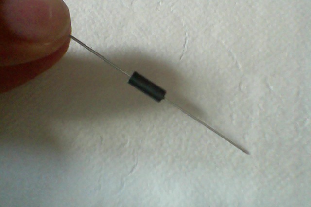

I am in the process of building my lxd (I bought the lxr kit from the shop). At step 9 of the assembly instructions you need to solder the Inductance 10uH. But in my kit there is no thingie that looks like the one in the picture
There is only one thingie left in my kit which looks a bit like a diode. It is totally black with no label.
Does anybody can tell me if this is the Inductance I need in step 9?
Thanks a lot!
  • yep - thats a ferrit bead.
    I have to update the assembly guide picture.
    ferrite beads are also an inductance and filter out the high frequency noise only.
