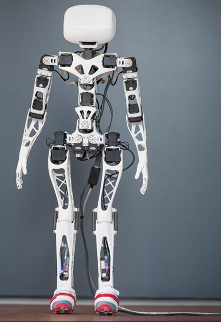

    We did this for another project called poppy -> http://wiki.poppy-project.org/
    explanation: while I am on the poppy git hub branch... I can update some pages (special branch dedicated to the mediawiki) on the GITHUB and then I see the update of those pages on the wiki as soon as I commit :-)
    it is very good, as you can make a file dedicated to install instructions, tuto to build a new function, etc... you update information on a centralized platform that is also P2P (GIT)... so I can also update when I am off (no network).

    poppy looks really great!
