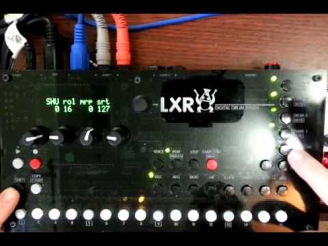

This feature, which was suggested by @tb323 in another thread will allow you to "rotate" the pattern you have entered for a specific voice in realtime. I thought this was a great idea because it opens up some more live performance possibilities.
I've created a demo video here:
To use the new feature, select the voice you want to rotate, and then enter performance mode by pushing the perf button. Now hold down the shift button and you should see the left most LED blinking. This indicates the amount of rotation in effect. Leftmost LED means 0 or none. So if you push the next LED  it will blink instead, and means the pattern will be rotated by 1 sixteenth note and so on up to 15. If you push the first step again it will be reset to no rotation and should go back to as though you had not rotated it. If your pattern length is less than 16, and you try to rotate above that length it will just calculate the wrap around amount, so all should be as expected.

  • Would it be possible to instead of seeing first step of track, see the hole programmed track and move the start point with the encoder? And visually see the programmed steps move?
    As a little strange bonus feature maybe it would be cool to have start point as a modulation destination so a LFO could modulate start point!
    If you can access sub steps with the pattern rotation and modulate start point with LFO you could add a "human touch" to timing on each track.

  • Interesting ideas @drkorg. The reason I didn't tie the start point to the encoder was because I wanted to be able to precisely and instantaneously jump to a specific position. The humanize idea is an interesting one, and might bear some playing around with independent of the pattern rotation.
