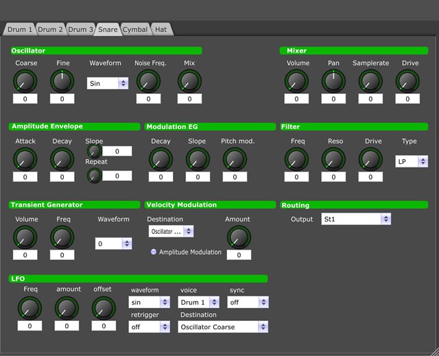

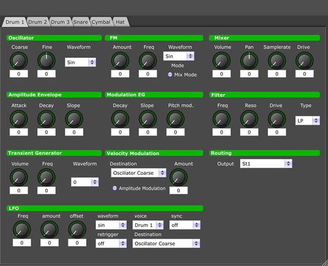

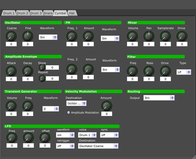

I have a very basic version of a software editor for the drumsynth. So far it is only able to send sound parameters to the device via midi.
It's main purpose so far was to test the midi/NRPN implementation ;)
As I am not the best surface designer and my 1st priority at the moment is getting the firmware and kits ready, maybe one of you wants to design a nice skin or a better layout?
The whole thing is JUCE based. So it should be able to run on almost all platforms. But so far I have only set up a working VC08 windows build.
The panels can be edited with the graphical 'Jucer ' editor, knobs are designed using knobman
I will publish the source on my GitHub soon.

    Julian, would it be too much to ask for you to post screenshots of the other pages? I'm sure many others would like to see the other parameters available! (I certainly would!)
  • edited March 2013
    here you go
  • Slightly late reply but oh boy, this is looking good! Thanks Julian.
  • Yes, very nice!
