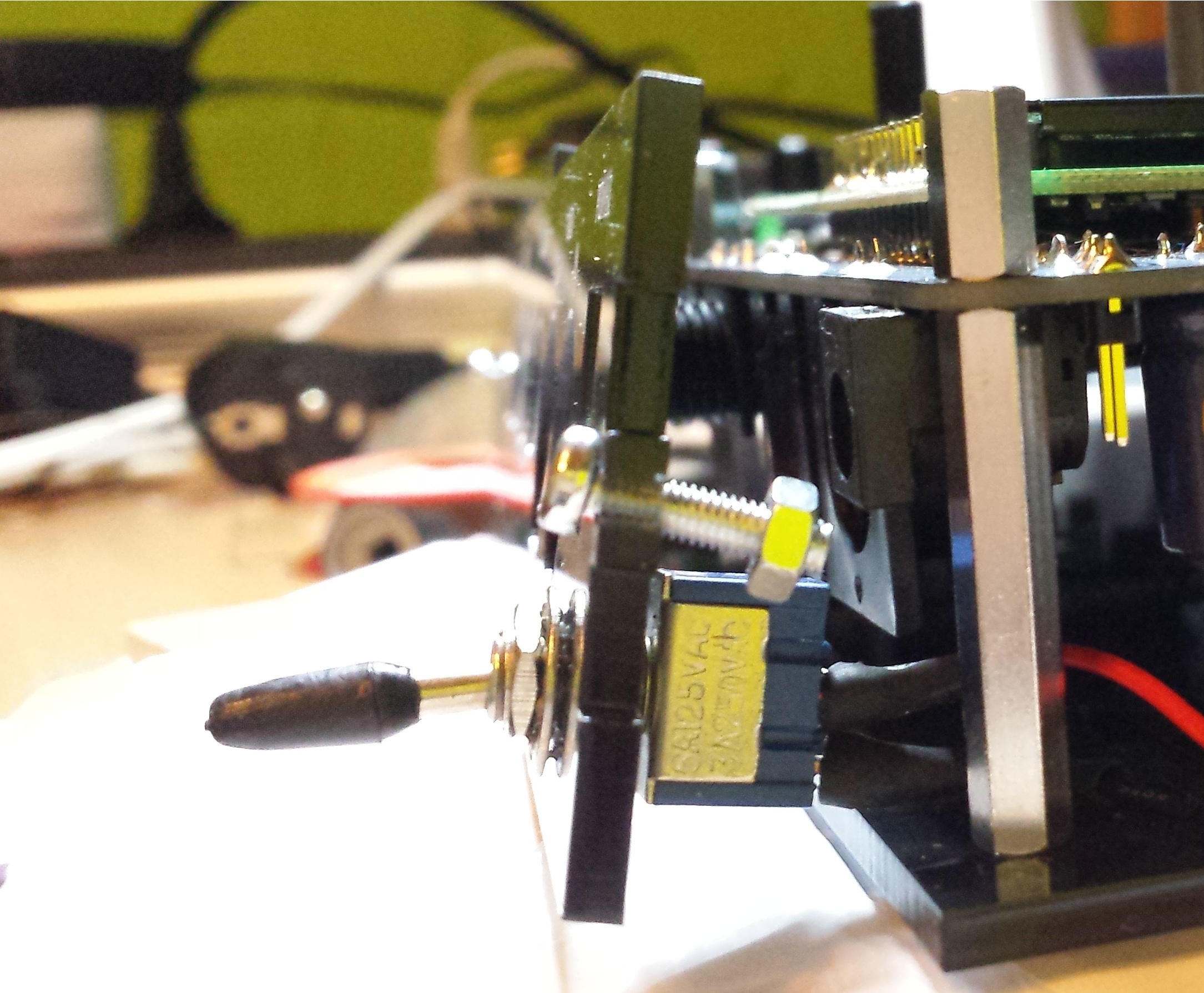

in first step i added a powerswitch fon a friends LXR,
(i´m soldered pinheaders to connect the cables with a 2 pin connector at beginning of the building - i replaced a jumper ..)
 you can see in picture 2, that the powerconnection cable limited the switch usage a bit..

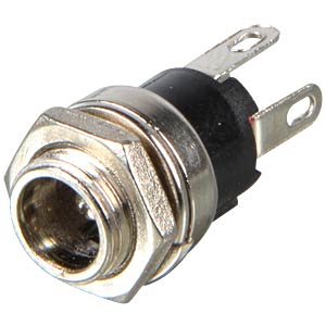

so i have to redesign the rearpanel without the powerconnection square cut, - later i place there  2 holes - one at the top for a switch and one for a powerconnection port ( see picture 3)
